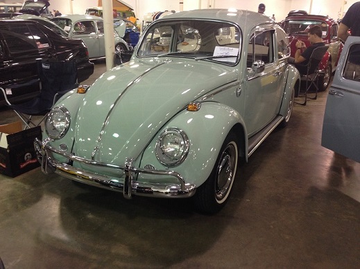

Happy to help. I started my project 5 years ago and found this site to be a very valuable source of information. It took me a year to complete, and that was working on it almost every day. (I'm retired!).
I've owned it for 26 years. I bought it from the estate of the original owner. Today it has only 46700 original miles.
VW Show.jpg (88.53 KiB) Viewed 22677 times
VERY nice!!! Sure brings back the memories of what mine looked like back in the summer of 1969 ....right down to the thin-line whitewall tires!!! Curious: do you have coloured running board mats ...or are they black. The experts say the mats should be 'Alpine Blue' ...frankly, I don't remember from back in the day. I note that you have used black fender-beading ...I'm going to try to re-use my original body-colour beading if I can clean the pink paint off of it. Yes ...some idiot spray-canned my car PINK !! Good grief!!
