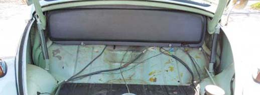

Hi Folks,
It's been a while since I've been on here, but I'm just getting towards the end of my 1966 bug restoration :)
Does anyone have any photographs of the original routing for the under-dash heater pipes? I've got the Y pieces, but not sure exactly where they should be and how the tubes should be run. Am I right in thinking the two brackets on the boot (trunk) floor near the door pillars are for securing the heater tubes?
As it stands now...
Thanks :)

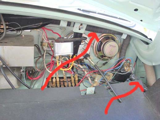

Thanks for the link. I know what parts there are, I just can't see how they fit/route under the hood to connect together without getting in the way of the hinge mechanism :)
Here's a couple of shots of the hose locations ...as the hoses come out of the wheel well area. The outer-most hoses go to the windshield lower right and left corner heat outlets, and the inner-most hoses are routed to the dash center vent outlet. On the driverside, the black hose snakes up over the radio speaker, and on the passenger side, it snakes up over the glove box. There are metal straps on the body to hold the hoses in place. Pretty straightforward, really.
