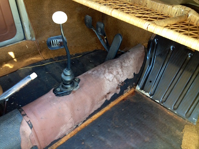

The previous owner didn't have much information, so I'm trying to figure out what was the original set up when the car was originally manufactured. I found left overs of the original mats under the current ones. I attached a pic. At first I thought it was a faded teak color but I'm now wondering if it was actually red.
What were the options for early '66 rubber mats (black or red)? If it was red, should all panels and seats be red as well?
My vin is # 116056650

You are correct. If red mats the sears and doors should also be red. As an over 50 year old car it could have undergone a few transformations. Look at this all original 66 for sale:

Our 66 has the red floor mats pictured in the original car listing. It too has faded to a dried out old mauve color. I sure like the car advertised.
I'll have to buy black ones when I do the interior, but I'll miss the red ones.

Dyeing the floor mats is an option that some people have done. I have no experience in this.
I recently came across this thread I started a few years ago and I realized that the original information I provided could be misleading for whoever is in the process of stock restoration of a 1966 L568 sea-sand or L87 pearl white euro spec bug. At the time I was trying to figure out the color of my original rubber mats based on US specs and I couldn't find the correct answer. After a few years I figured out that VW created the teak colored door panels with matching rubber mats for the European market only (mine are faded, and not true to the original color anymore). In the US the interior door panels were offered in black, red or platinum/grey depending on the exterior color of the car. But if you have a European imported bug with teak colored panels like mine and you have any interest in keeping it original or restoring the original look, then you'll want mosaic-teak cloth with teak vinyl inserts for front and back seats, brown (VW used the word "rust color" for brown) seat frames and kick panels, teak colored rubber mats, caramel running boards, and sea-sand fender beadings. I hope this helps and big thanks to h~moto for helping me to figuring it all out...
