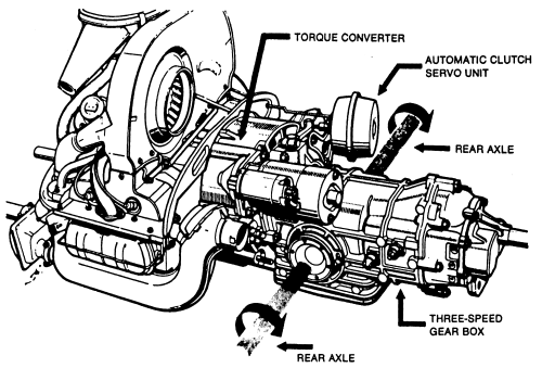

Auto Stick Shift Starter
The auto stick shift transaxle housing was shaped differently that the standard clutch transaxle for the old beetles. The case was kind of square at the outer edge (having a flange about 2-3 inches toward the front of the car then rounding back off) to make room for the torque converter and clutch assembly as opposed to the clutch model transaxle which is rounded almso from the starting edgo of the engine/trans mating surface. The auto stick shift starter will not fit in the clutch transaxle unless you want to modify the clutch transaxle case to accomidate the auto stick shift starter. That might be a fun project.

- autostickshift.gif (59.54 KiB) Viewed 16580 times

Hey Darzoom,
Thanks for the picture... I now get what you mean by the 2-3 inch flange.
Also good seeing a pic of an auto transmission... were this models in large no? I'd love to see one.

Not Sure
I owned a 1968 model that wa the first year it was introduced. They produced it until 1976. It was orginally a Porsche design (Tiptronic) that was adapted for the VW and was also used in VW commerical vehicles in Europe.
It was an interesting design with a 3 speed true gear box unlike other automatic transmissions that used bands and drums and were acturated with hydralic pressure. The Autostick had a torque converter and a true clutch and pressure plate. The torque converter allowed the slip to get moving. The clutch was activated by a vacum booster that was triggered by points at the bottom of the shifter that enguaged the clutch to allow the gears to change. It was not a fluid drive like traditional automatics.
I am not sure on how many were produced.
