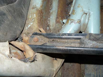

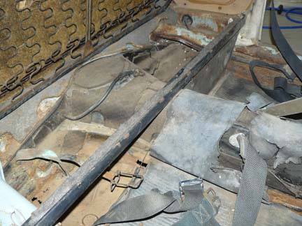

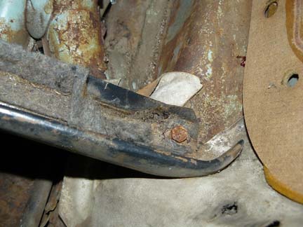

Just a standard 10mm bolt, about a half-inch long. The bar that supports the front edge of the rear seat bottom is like a piece of angel-iron laid flat to form a ledge that the rear seat bottom front edge sits on. There are two bolts :one at each end, just below the door post. No bolt in the centre ...just a lump that fits into a divit in the floor hump. If you're trying to do a "parts perfect" restoration, you'll have to find another bug to salvage this part from ...or fabricate one out of some angle iron that is one-inch wide on each side. See pics for what the actual support looks like.
Driver side
Driver side
passenger side
passenger side
Support bar
Support bar
