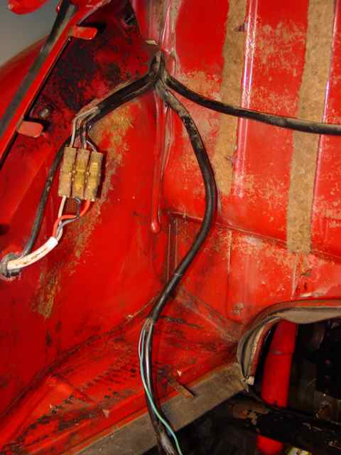

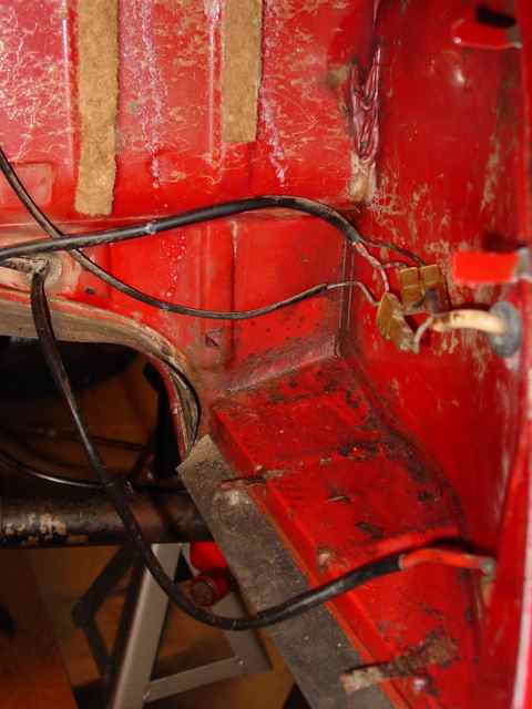

I had an issue with my brake lights. My car had been stored in a barn for 6 years and rodents had nested behind the insulation panels on both sides of the engine compartment. I didn't realize that there were connector blocks for both rear light harnesses. I have since replaced the entire wiring harness which I highly recommend. But at the time I pulled apart these blocks and cleaned up the contacts. You also need to make sure that the brake light switch located on the brake master cylinder is working properly. I hope this helps.
- Right side of the engine compartment. This is what you will find if you remove the fiberboard piece.

- You can remove these without taking out the rear fiberboard. You need to take your time not to tear up the pieces. They flex.
