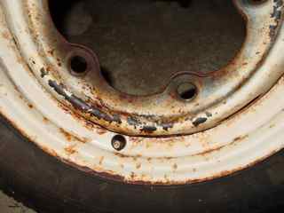

I have some pretty nasty looking stock rims that I would like to restore. Any tips on how to do a quality job? Are there masks you can purchase or put together. I'm an amateur when it comes to auto paint, so this will be a challenge. Maybe the best bet is to turn them over to a pro, but I"m guessing it won't be cheap.

Rims are looking pretty rough.

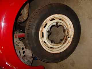

Did you use the exact stock white, which tends to be a bit on the bluish side? My spare is still in pretty good shape and is two tone with the blue cream color.
Mike
It is actually a very light shade of blue, and you are right it can look almost white but it is the stock color for the rims. $25.00 per rim is a good price on the powder coating! The beauty of the powder coating is that it will last a long time!

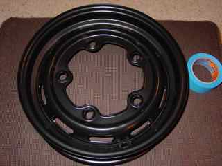

Just powder coated, ready for masking.

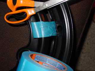

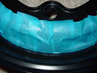

3M painters tape works well. It took a while but I found this to be the easiest way to mask the rims.

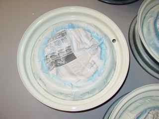

The masked and painted rims
