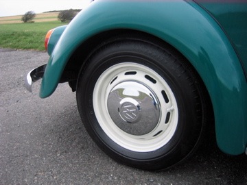

My bug shown here has the correct wheels :)
BORIS beachy head 013.jpg (35.99 KiB) Viewed 37653 times
Mangels don't match the '66 VW wheel. They are early Porsche style with hubcap clips. Your car should have the '66-'67 style with 10 ventilation slots and no hubcap clips. (Hubcap is held by three nubs in the rim.)
Stock VW rims are date coded, so you should look for dates between 9/65 and 7/67.

Boris1966 wrote:My bug shown here has the correct wheels :)
Is this tubeless tires? original lip?
scruffy wrote:mine are wide five with clips.
Then they're not stock '66 VW.
Those are the correct '66 tubeless rims, however the paint pattern is not stock.
