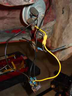

My horn stopped working, and I made an attempt to diagnose the problem today. I asked my wife to jump into the driver's seat, turn the key on and press the horn ring when I gave her a signal. I got underneath the car, disconnected the ground wire and attached a jumper wire to the terminal. I then touched the end of the jumper wire to clean bare metal. The horn went off, and I asked my wife to wait for my signal. She replied that she had switched the power on but that she had not touched the horn ring. I tried touching the wire to bare metal a couple more times, always with the same result--the horn sounded without my wife touching the horn ring.

Just went through a horn repair on mine. If the horn sounds without touching the horn ring, somewhere between the brown wire from the horn and the nut holding the wheel on, including the steering column tube itself, the control ciruit is grounded. The horn ring is an open in the gound circuit. Push on the horn ring and you connect the powered steering column to the brown wire running down the center of the steering shaft. This wire in turn is conntected to the steering box side of the steering coupler. Hope that helps.
