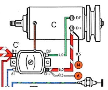

Has anyone relocated the voltage regulator from the engine area to under the rear seat? I know that my '68 had it under the rear seat from the factory, but I just had my '66 bug's motor rebuilt and received it back without the voltage regulator and was told I need to install one under the rear seat. Has anyone done this? Or can anyone give advice on how to do this, including what wiring steps, wiring sizes, connections etc. are necessary? Thanks for any help.

If you have the stock wiring harness and want the VR under the seat, look at the attached wiring diagram (also in the tech section) to determine which wires need to be separated from the loom under the seat.
The hardest part will be removing the insulation from the loom and not cracking ~50 year old wire. If you want to insert new wires from the under seat location on (would be my choice) and make a new charging loom only, 16 gauge is adequate for most leads except for main charging lead which should be 8 or 10 gauge wire. Connectors will be determined by what is needed at the generator and the VR.

- gen wiring.jpg (18.69 KiB) Viewed 82930 times

Thanks for the info. Yes, the car in The Samba is mine. This will by no means be any kind of show car, and I wasn't planning on putting new wiring, but unfortunately my motor rebuilder didn't give me the wiring portion of the VR, so now I'm stuck with the task of figuring how to wire the new VR (on order) properly. Do you think I should see about purchasing a used VR wiring and using that?
If the wires to the engine compartment are missing (strange the engine builder would cut them out), you can open the loom under the seat and add wire as needed to the engine compartment. The VR will determine the needed connectors.
Or, install under the seat and extend with new wires to the engine compartment and starter. It is only 3 wires so should be pretty easy.
As far as a new or used VR wiring, I would not purchase 50+ year old wire. The wiring diagram is on the main page under "Wiring Diagram" so you can see what wires are needed.
You can do this. Good luck!

For some reason the guy rebuilding my motor thought my bug was a later model than a '66, and assumed I was going to have a VR under my back seat. I'm still shaking my head at this whole ordeal. I think to make things simpler, I'm going to stick to mounting it on the fan shroud and see if I can get some kind of diagram that shows what wires go where and find what gauge wire is needed. Otherwise, I may have to rely on 50 year old wiring to get me through this. I'd like to get my bug on the road this year!darzoom wrote:If the wires to the engine compartment are missing (strange the engine builder would cut them out), you can open the loom under the seat and add wire as needed to the engine compartment. The VR will determine the needed connectors.
I attached the wiring diagram for the VR, generator and starter earlier in this post. The complete diagram is on the main page. Also, the wire size for the large wires is 8 or 10 gauge and the smaller idiot light wire is 16 gauge. BTW, there is a lot of vibration on the shroud and the sheet metal screws may work out as evidenced by the pictures of the shroud on the Samba. If you can not mount it solid on top of the generator, you may want to consider mounting on the right side of the firewall where the wires come through. Then create a short harness from there.
