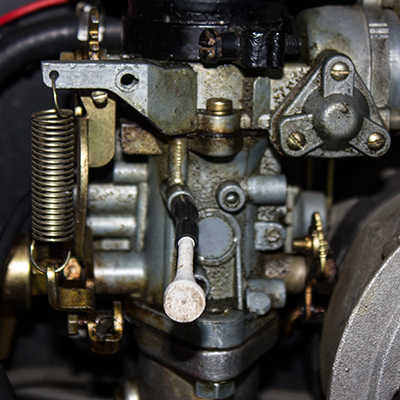

Hi folks. New owner of a '66. It seems there's a golf tee in my carburetor (which is a Solex 34 Pict-3, as I understand it. Make and model of tee unknown.) Photo attached.
I assume the tee has been used to block off something, but can anyone tell me:
1. Specifically, why is the tee there?
2. Should I replace it with something more appropriate?
Thanks,
Jason
Appears to be blocking the vacuum used for distributor or other vacuum need like air cleaner. There are rubber caps that can also be used. Some carbs had up to 3 vacuum ports. Maybe a tee color matched to the car?

You can buy a little pack of the block-offs at any auto parts store. Normally a pack has a few different sizes and colors. I call them squirrel or gerbil condoms, depending on the size.
